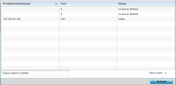

To view the Sensor Server statistics:
| IP Address |
Displays a list of sensor server IP addresses. These are sensor resources available to the controller or service platform. |
| Port |
Displays the port on which this server is listening. |
| Status |
Displays whether the server is currently connected or not connected. |
