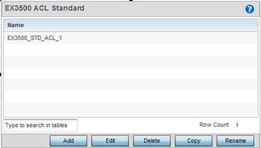

Select from the Web UI.
The EX3500 ACL Standard
screen displays within the main portion of the Web UI.
EX3500 ACL Standard Screen
Select Add to create a new ACL,
Edit to modify the
attributes of an existing ACL, or Delete to remove obsolete ACLs.
Use Copy to create a copy of the
selected ACL and modify it for further use. Use Rename to rename the selected
ACL.
Either use Add to create a new EX3500
Standard ACL, or select an existing ACL and click Edit to edit it.
The following screen displays.

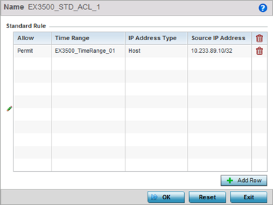

EX3500 ACL Standard - Add/Edit Screen
If you are adding a new EX3500 ACL Standard, provide
it a name with up to 32 characters.
To add a new standard rule, click Add Row.
EX3500 ACL Standard - Add/Edit - Standard Rule
Screen
Provide the following details:
| Source IP Address |
Use this drop-down menu to provide
the source information. Source IP address can be one of Any,
Host or Network. When selecting Host provide the IP address
of the host device. When selecting Network, provide the IP
address of the network along with the mask. |
| Allow |
indicate the action to be performed. Select from Permit or
Deny. |
| Time Range |
From the drop-down menu select the
preconfigured time range to use for this ACL. Select None to
indicate no preference. For more
information on time ranges, see EX3500 Time Range.
Select OK when completed to update
the EX3500 Standard ACL.
Select Reset to revert the screen to
its last saved configuration.
