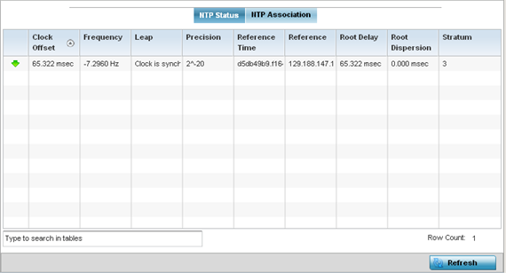

The NTP Status screen displays performance (status) information relative to the NTP association status. Verify NTP status to assess the controller or service platform's current NTP resource.
To view the NTP status of a controller or service platform managed network:
| Clock Offset |
Displays the time differential between the controller or service platform time and the NTP resource's time. |
| Frequency |
An SNTP server clock‘s skew (difference) for the controller or service platform and the dedicated NTP resource. |
| Leap |
Indicates if a second is added or subtracted to SNTP packet transmissions, or if transmissions are synchronized. |
| Precision |
Displays the precision of the time clock (in Hz). The values that normally appear in this field range from -6 for mains-frequency clocks to -20 for microsecond clocks. |
| Reference Time |
Displays the time stamp the local clock was last set or corrected. |
| Reference |
Displays the address of the time source the controller or service platform is synchronized to. |
| Root Delay |
The total round-trip delay in seconds. This variable can take on both positive and negative values, depending on relative time and frequency offsets. The values that normally appear in this field range from negative values (a few milliseconds) to positive values (several hundred milliseconds). |
| Root Dispersion |
The difference between the time on the root NTP server and it's reference clock. The reference clock is the clock used by the NTP server to set its own clock. |
| Stratum |
Displays how many hops the controller or service platform is from its current NTP time source. |
