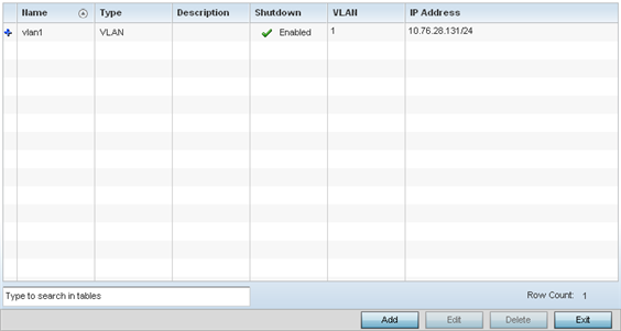

    Profile Overrides - Virtual Interfaces Screen
  5. Review the following parameters unique to each virtual interface configuration to determine whether a parameter override is warranted:
    Name The name of each listed virtual interface assigned when it was created. The name is between 1 - 4094, and cannot be modified as part of a virtual interface edit.
    Type The type of virtual interface for each listed interface.
    Description The description defined for the virtual interface, either when it was created or when it was edited.
    Admin Status A green check mark means the listed virtual interface configuration is active and enabled with its supported profile. A red “X” means the virtual interface is currently shut down. The interface status can be modified when a new virtual interface is created or an existing one modified.
    VLAN The numerical VLAN ID associated with each listed interface.
    IP Address Whether DHCP was used to obtain the primary IP address used by the virtual interface configuration.
