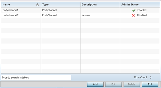

Controller, service platform and access point profiles can be applied customized port channel settings as part of their interface configuration.
To define a port channel configuration for a device profile:
Select Configuration → Profiles.
The Profile screen, listing device profiles, is displayed.
The profile's configuration menu is displayed.
Expand the Interface menu and select Port Channels.
Refer to the following to review existing port channel configurations and their current status:
| Name |
Displays the port channel's numerical identifier assigned to it when it was created. The numerical name cannot be modified as part of the edit process. |
| Type |
Displays whether the type is port channel. |
| Description |
Lists a short description (64 characters maximum) describing the port channel or differentiating it from others with similar configurations. |
| Admin Status |
A green checkmark defines the listed port channel as active and currently enabled with the profile. A red "X" defines the port channel as currently disabled and not available for use. The interface status can be modified with the port channel configuration as required. |
