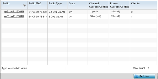

The radio Status screen provides radio association data, including radio ID, connected APs, radio type, quality index and SNR.
To view the radio status statistics:
The screen displays by default.
The Radios Status screen provides the following information:
| Radio | Displays the model and numerical value assigned to the radio as its unique identifier. Optionally, select the listed radio (it displays as a link) to display radio configuration information in greater detail. |
| Radio MAC | Displays the MAC address assigned to the radio as its unique hardware identifier. |
| Radio Type | Defines whether the radio is operating in the 2.4 GHz or 5 GHz radio band. |
| access point | Displays the administrator-assigned system name of each listed AP. Optionally, select the listed AP's link to view configuration information in greater detail. |
| AP Type | Lists the model type of the AP housing the listed radio. |
| State | Displays the current operational state of each radio. |
| Channel Current (Config) | Displays the administrator configured channel each listed radio is broadcasting on. |
| Power Current (Config) | Displays the administrator configured power level the radio is using for its transmissions. |
| Clients | Displays the number of wireless clients associated with each listed radio. This value helps assess whether the client load is optimally distributed amongst available AP radios. |
