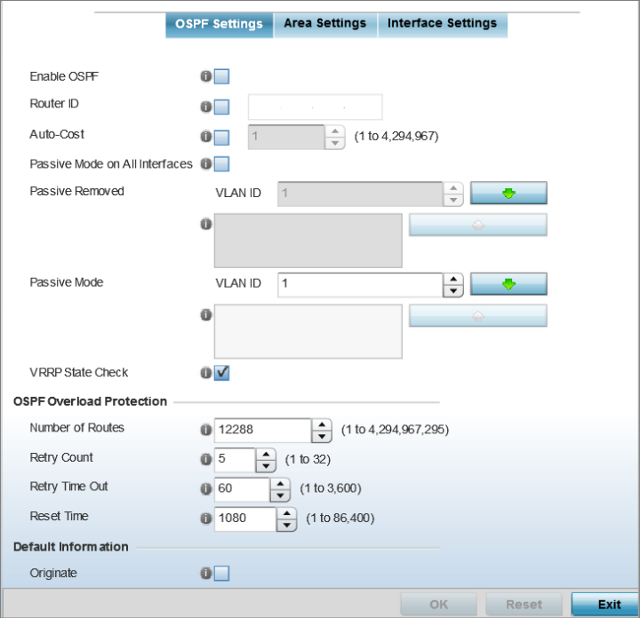

To override a profile's OSPF configurations:
The Device Configuration screen displays. This screen lists wireless controllers, service platforms and access points within the managed network.
The selected device's configuration screen displays.
The configuration screen displays.
Router ID |
Select this option to define a router ID (numeric IP address). This ID must be established in every OSPF instance. If not explicitly configured, the highest logical IP address is duplicated as the router identifier. However, since the router identifier is not an IP address, it does not have to be a part of any routable subnet in the network. |
Auto-Cost |
Select this option to specify the reference bandwidth (in Mbps) used to calculate the OSPF interface cost if OSPF is either STUB or NSSA. The default setting is 1. |
Passive Mode on All Interfaces |
When selected, all layer 3 interfaces are set as an OSPF passive interface. This setting is disabled by default. |
Passive Removed |
If enabling Passive Mode on All Interfaces, use the spinner control to select VLANs (by numeric ID) as OSPF non passive interfaces. Multiple VLANs can be added to the list. |
Passive Mode |
If disabling Passive Mode on All Interfaces, use the spinner control to select VLANs (by numeric ID) as OSPF passive interfaces. Multiple VLANs can be added to the list. |
VRRP State Check |
Select this option to enable checking of VRRP state. If the interface‘s VRRP state is not Backup, then the interface is published via OSPF. |
Number of Routes |
Use the spinner controller to set the maximum number of OSPN routes permitted. The available range is from 1 - 4,294,967,295. |
Retry Count |
Set the maximum number of retries (OSPF resets) permitted before the OSPF process is shut down. The available range is from 1 - 32. The default setting is 5. |
Retry Time Out |
Set the duration (in seconds) the OSPF process remains off before initiating its next retry. The available range is from 1 - 3,600 seconds. The default is 60 seconds. |
Reset Time |
Set the reset time (in seconds) that, when exceeded, changes the retry count is zero. The available range is from 1 - 86,400. The default is 360 seconds. |
