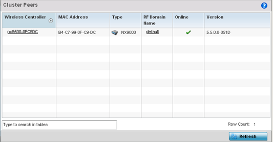

Refer to the Cluster Peers screen to review device address and version information for peer devices within a cluster.
To view cluster peer statistics:
| Wireless Controller | Displays the IP addresses of current cluster member controller or service platform. The name displays in the form of a link that can be selected to display a detailed description of the controller or service platform‘s configuration. |
| MAC Address | Displays the MAC addresses of current cluster members. |
| Type | Displays the type of cluster peer. |
| RF Domain Name | Displays each member's RF Domain name. The name displays in the form of a link that can be selected to display a detailed description of the RF Domain's configuration. |
| Online | Displays whether a cluster member is currently online. If online, a green check mark displays, if it is offline a red X displays. |
| Version | Displays the numeric firmware version currently running controller or service platform. Use this version as the basis for comparison on whether newer versions are available from the support site that may provide increased functionality and a broader feature set. |
| Refresh |
Select to update the screen's statistics counters to their latest values. |
