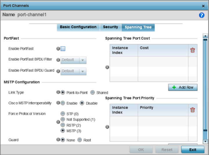

Overriding Spanning Tree Configuration
To configure the port channel's spanning tree configuration:
  1. Select the Spanning Tree tab.
    Port Channels - Spanning Tree Screen
  2. Define or override the following PortFast parameters for the port channel‘s MSTP configuration:
    Enable PortFast

  3. Set or override the following MSTP Configuration parameters for the port channel:
    Enable as Edge Port
    Select this option to define this port as an edge port. Using an edge (private) port, you can isolate devices to prevent connectivity over this port channel. This setting is disabled by default.
    Link Type
    Select either Point-to-Point or Shared. When Point-to-Point is selected, the port is treated as connected to a point-to-point link. Selecting Shared means this port should be treated as having a shared connection.

  4. Refer to the Spanning Tree Port Cost table.
    Define or override an Instance Index using the spinner control, and set its corresponding cost in the Cost column. The default path cost depends on the user defined port speed. The cost helps determine the role of the port channel in the MSTP network.
    The designated cost is the cost for a packet to travel from this port to the root in the MSTP configuration. The slower the media, higher the cost.

    Select + Add Row as needed to include additional indexes.
  5. Refer to the Spanning Tree Port Priority table.
    Define or override an Instance Index using the spinner control, then set the Priority. The lower the priority, the greater likelihood of the port becoming a designated port.
  6. Click OK to save the changes and overrides made to the Ethernet port's Spanning Tree configuration.
