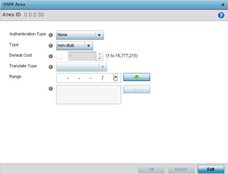

You can add a new Area configuration or edit an existing configuration.
Set the following OSPF Area configurations:
| Area ID |
If adding a new OSPF Area, use the drop-down menu and specify the Area ID either as an IP address or Integer. |
| Authentication Type |
Select either None, simple-password or message-digest as the credential validation scheme used with the OSPF dynamic route. The default setting is None (no data protection). |
| Type |
Set the OSPF area type as either stub, totally-stub, nssa, totally-nssa or non-stub. |
| Default Cost |
Select this option to set the default summary cost advertised if creating a stub. Set a value from 1 - 16, 777,215. |
| Translate Type |
Define how messages are translated. Options include translate-candidate, translate always and translate-never. The default setting is translate-candidate. |
| Range |
Specify a range of addresses for routes matching address/mask for OSPF summarization. |
Select the OK button to save the changes to the area configuration. Select Reset to revert to the last saved configuration.
