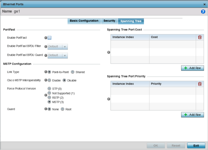

To edit or override spanning tree configuration of the selected port:
Enable as Edge Port |
Select this option to define this port as an edge port. Using an edge (private) port, you can isolate devices to prevent connectivity over this port. |
Link Type |
Select either Point-to-Point or Shared. When Point-to-Point is selected, the port is treated as connected to a point-to-point link. When Shared is selected, the port is shared between multiple devices. An example of a Point-to-Point connection is a port that is connected to a controller or service platform. An example of a Shared connection is a port that is connected to a hub. |
Cisco MSTP Interoperability |
Enable or Disable interoperability with Cisco‘s version of MSTP over the port. Cisco's version of MSTP is incompatible with standard MSTP. |
Force Protocol Version |
Select STP to use the standard Spanning Tree Protocol. Select RSTP to use Rapid Spanning Tree Protocol. Select MSTP to use Multiple Spanning Tree Protocol. Select Not Supported to disable spanning tree protocol for this interface. MSTP is the default setting. |
Guard |
Select Root radio to ensure that the port is a designated port. Typically, each guard root port is a designated port, unless two or more ports (within the root bridge) are connected together. If the bridge receives superior BPDUs on a guard root-enabled port, the guard root moves the port to a root-inconsistent STP state. This state is equivalent to a listening state. No data is forwarded across the port. Thus, the guard root enforces the root bridge position. Select None to disable this feature. |
Enable PortFast |
Select this option to enable drop-down menus for both the Enable PortFast BPDU Filter and Enable PortFast BPDU Guard options for the port. |
Enable PortFast BPDU Filter |
Select this option to invoke a BPDU filter for this PortFast enabled port. Enabling the BPDU filter feature ensures this PortFast enabled port does not transmit or receive BPDUs. |
Enable PortFast BPDU Guard |
Select this option to invoke a BPDU guard for this PortFast enabled port. Enabling the BPDU guard feature means that this PortFast enabled port will shut down when it receives BPDU messages. |
Define or override an Instance Index using the spinner control, and set its corresponding cost in the Cost column.
The default path cost depends on the user-defined speed of the port. The cost helps determine the role of the port in the MSTP network. The designated cost is the cost for a packet to travel from this port to the root in the MSTP configuration. The slower the media, the higher the cost.
Spanning Tree Port Cost

Select + Add Row as needed to include additional indexes.
Define or override an Instance Index using the spinner control, and set its corresponding priority in the Priority column.
The lower the priority, the greater likelihood of the port becoming a designated port. Applying a higher override value impacts the port‘s likelihood of becoming a designated port..
