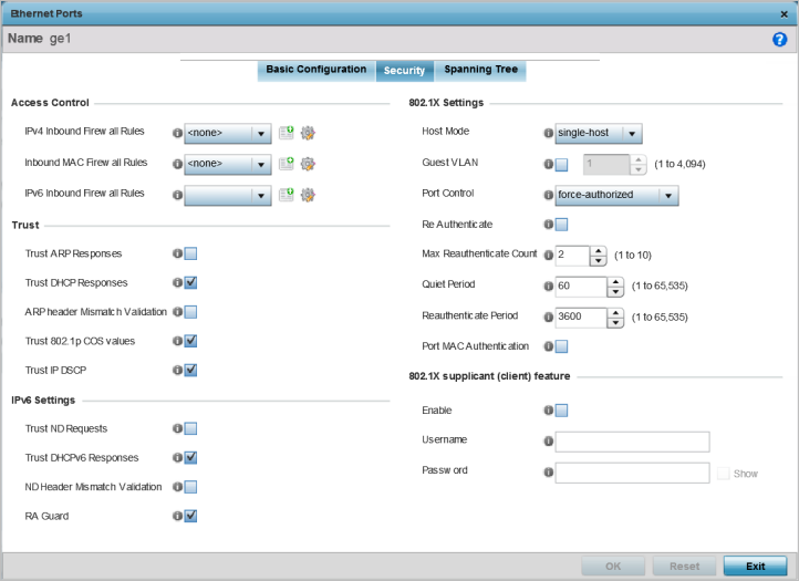

To edit or override security configuration of a port:
The selected port's security configuration screen displays.

Trust ARP Responses |
Select this option to enable ARP trust on this port. ARP packets received on this port are considered trusted, and the information from these packets is used to identify rogue devices within the network. This option is disabled by default. |
Trust DHCP Responses |
Select this option to enable DHCP trust on this port. If enabled, only DHCP responses are trusted and forwarded on this port, and a DHCP server can be connected only to a DHCP trusted port. This option is enabled by default. |
ARP header Mismatch Validation |
Select this option to enable a mismatch check for the source MAC in both the ARP and Ethernet header. This option is disabled by default. |
Trust 802.1p COS values |
Select this option to enable 802.1p COS values on this port. This option is enabled by default. |
Trust IP DSCP |
Select this option to enable IP DSCP values on this port. This option is enabled by default. |
Some vendor solutions with VRRP enabled send ARP packets with Ethernet SMAC as a physical MAC and inner ARP SMAC as VRRP MAC. If this configuration is enabled, a packet is allowed, even when a conflict exists.
Trust ND Requests |
Select this option to enable the trust of neighbor discovery requests required on an IPv6 network on this Ethernet port. This option is disabled by default. |
Trust DHCPv6 Responses |
Select this option to trust all DHCPv6 responses on this Ethernet port. DHCPv6 is a networking protocol for configuring IPv6 hosts with IP addresses, IP prefixes, or other configuration attributes required on an IPv6 network. This option is enabled by default. |
ND Header Mismatch Validation |
Select this option to enable a mismatch check for the source MAC within the ND header and Link Layer Option. This option is disabled by default. |
RA Guard |
Select this option to enable router advertisements or ICMPv6 redirects from this Ethernet port. This option is enabled by default. |
Host Mode |
Select the port mode for 802.1X authentication. Select single-host to bridge traffic from a single authenticated host. Select multi-host to bridge traffic from any host to this port. The default setting is single-host. |
Guest VLAN |
Specify a guest VLAN for this port from 1 - 4094. This is the VLAN traffic is bridged on if this port is unauthorized and the guest VLAN is globally enabled. |
Port Control |
Set the way in which the port bridges traffic. Select one of the following options:
The default setting is force-authorized. |
Reauthenticate |
Select this setting to force clients to reauthenticate on this port. The default setting is disabled, thus clients do not need to reauthenticate for connection over this port until this setting is enabled. |
Max Reauthenticate Count |
Set the number of reauthentication attempts (1-10) when a port tries to reauthenticate and fails. Once this count exceeds, the port is considered unauthorized. The default setting is 2. |
Quiet Period |
Set the quiet period for this port from 1 - 65,535 seconds. This is the maximum wait time 802.1x waits upon a failed authentication attempt. The default setting is 60 seconds. |
Reauthenticate Period |
Set the duration after which a controlled port is forced to reauthenticate. Set a value from 0 - 65535 seconds. The default setting is 3600 seconds. |
Port MAC Authentication |
Enables MAC address authentication on the selected port. When enabled, a port‘s MAC address is authenticated, as only one MAC address is supported per wired port. When successfully authenticated, packets from the source are processed. Packets from all other sources are dropped. Port MAC authentication is supported on RFS 4000 model controllers. Port MAC authentication may be enabled on ports in conjunction with Wired 802.1x settings for a MAC Authentication AAA policy. This option is disabled by default. |
This setting is disabled by default. The password cannot exceed 32 characters.
