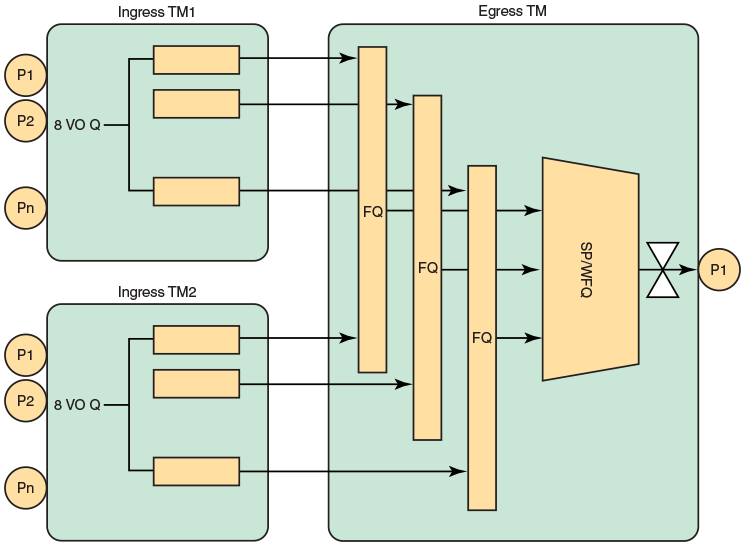

The figure below illustrates a QoS egress scheduling scheme.
In the figure above P1 is the insight interface.
