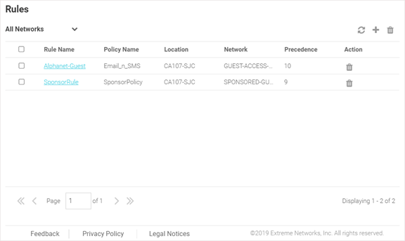

The Rules screen displays existing notification rules and their basic configuration. Double-click each rule to view the detailed configuration. Review the configuration details to determine if the rule warrants modification or removal.
Notification Rules Screen
The Rules screen displays following information:
Rule Name Displays the unique name assigned to the rule when it was created.
Policy Name Displays the name of the notification policy associated with the rule when it was created.
Location Displays the site that the notification rule applies to.
Network Displays the Network that the notification rule applies to.
Precedence Displays the precedence (sequence) of the rule. The precedence value of a rule determines its priority. Rules with higher precedence receive higher priority and are applied first. This value is set (from 1 - 1000) for new notification rule configurations.
Action Deletes a notification rule. To delete a rule, select the checkbox next to it and then select the GUID-62FE7F01-121E-434B-948B-67D2EF5A093F-low.png icon associated with the rule.
