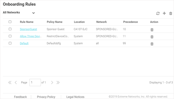

    The Onboarding Rules screen displays.
    Onboarding Rules Screen
  2. Configured onboarding rules display with the following information:
    Rule Name Displays the user configured rule name for each onboarding rule.
    Policy Name Displays the Policy Name associated with each rule.
    Location Displays the location associated with each rule. Locations are based on the network associated with the rule.
    Network Displays the network associated with each onboarding rule. A rule can also apply to All Networks.
    Precedence Displays the precedence number for each onboarding rule. Precedence determines which order rules are applied in with the higher precedence rules matched first.

  5. Use the Network pull-down menu to select the networks that the onboarding rule applies to. The default value is All Networks, which applies the rule to all networks.
  6. Use the Location pull-down menu to navigate the system tree and select the site that the onboarding rule applies to. The default value is System, which applies the rule to all locations.
  7. Use the Precedence Level spinner control to assign a precedence to the rule. The precedence value of a rule determines its priority.
    Lower the precedence value, higher is the priority. Rules with lower precedence will be applied first.
  8. Select Apply when complete to add the onboarding rule.
