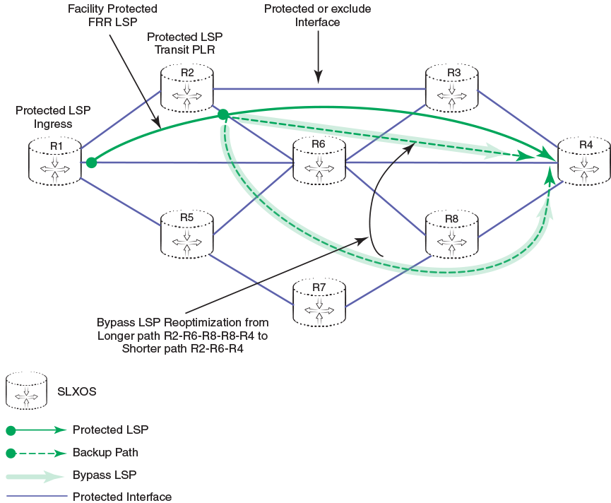

Below is an example of a bypass LSP re-optimization at an FRR LSP ingress.
Bypass LSP re-optimization at FRR LSP ingress

Below is an example for bypass LSP MBB due to re-optimization or a new instance commit.
Bypass LSP re-optimization at FRR LSP transit PLR
