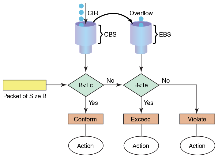

Single-rate traffic contract has there are three parameters, the, CIR, CBS and EBS. associated with this type of contract:
Marking is based on CIR and two associated burst sizes, CBS and EBS. Packets are marked: The SrTCM is useful for ingress policing of a service, where only the length, not the peak rate, of the burst determines service eligibility.
Single rate three color marker
Implementation
SrTCM traffic policing is implemented by tracking the current burst size using token-buckets, and discarding packets that exceed the CIR. In SrTCM the three color scheme has any incoming burst classified as either conforming (green, under CBS), exceeding (yellow, over CBS but under EBS), or violating (red, over EBS).
Every arriving packet is first compared to CBS and then to the EBS to determine the next action. There is a single flow of the tokens that fills the CBS bucket first and then continues to filling the EBS bucket. The second bucket is only filled if there was enough idle time to let the first bucket fill up completely.
