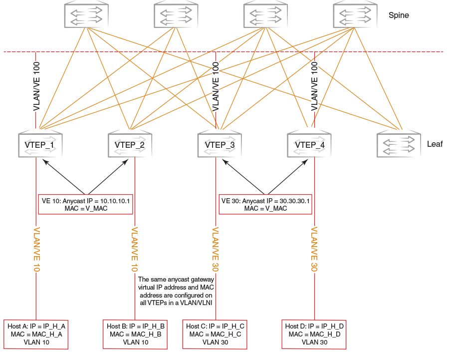

As shown in the following figure, all leaf switches for VLAN 10 are configured with the same MAC address and IP address.
Static anycast gateway
When the host sends an ARP request for the gateway IP address on VLAN 10, the ingress leaf switch intercepts the ARP request and responds with the VMAC address associated with anycast IP. This behavior is controlled for each VE interface.
