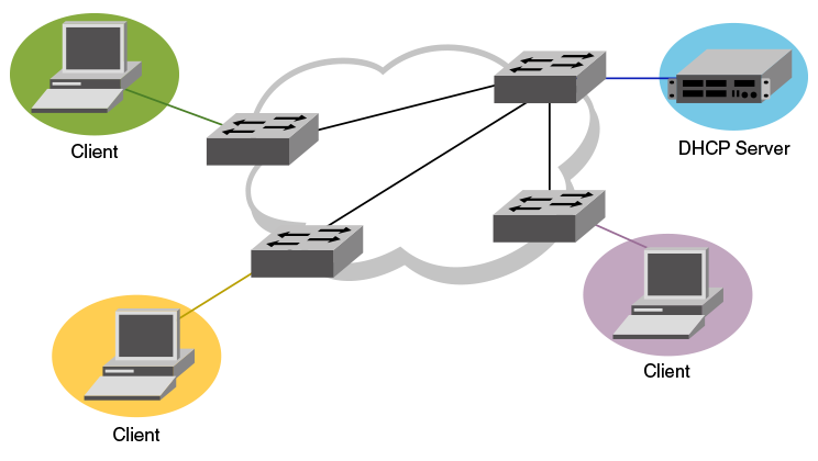

The illustration below shows four VRFs, with three of them connecting to the fourth for DHCP services. (For more information on working with DHCP IP Relay, refer to the "DHCPv4" chapter.)
Inter-VRF route leaking example for connecting clients to a DHCP server in a different VRF.
The following example shows setting up Inter-VRF route leaking and DHCP between the red VRF and the blue VRF.
