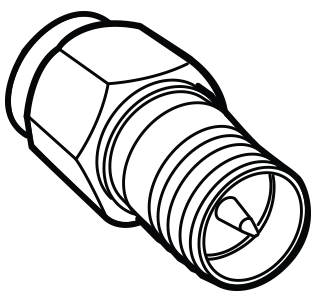

Reverse polarity (RP)-SMA jack type antenna connector
Reverse polarity SMA jack type antenna connector. The antenna connector threads are on the outside shell.
The reverse polarity jack type antenna connector has a center pin and the connector threads are outside the connector shell.

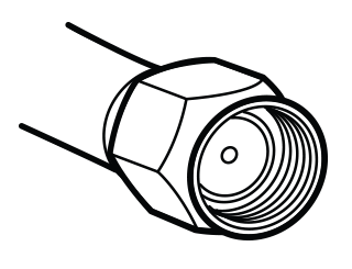

RP-SMA plug antenna connector
Reverse polarity SMA plug type antenna connector. The antenna connector threds are on the inside shell of the antenna.
The reverse polarity plug type connector has a hollow center socket and the connector threads are inside the connector shell.

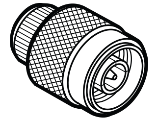

N-type standard plug connector
N-type standard plug connector.
The small N-type connectors are used during indoor installations and larger connectors are used for outdoor installations.
