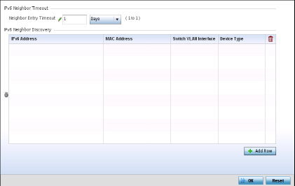

  3. Expand Network menu and select IPv6 Neighbor.
    IPv6 Neighbor screen
  4. Set an IPv6 Neighbor Entry Timeout in either Seconds (15 - 86,400), Minutes (1 - 1,440), Hours (1 - 24) or Days (1). The default setting is 1 hour.
  5. Select + Add Row, in the IPv6 Neighbor Discovery table to define the following:
    IPv6 Address
    Provide a static IPv6 IP address for neighbor discovery. IPv6 hosts can configure themselves automatically when connected to an IPv6 network using the Neighbor Discovery Protocol via ICMPv6 (Internet Control Message Protocol version 6) router discovery messages. When first connected to a network, a host sends a link-local router solicitation multicast request for its configuration parameters; routers respond to such a request with a router advertisement packet that contains Internet Layer configuration parameters. IPv6 addresses are composed of eight groups of four hexadecimal digits separated by colons.
    MAC Address
    Enter the hardware encoded MAC addresses of up to 256 IPv6 neighbor devices. A neighbor is interpreted as reachable when an acknowledgment is returned indicating packets have been received and processed. If packets are reaching the device, they‘re also reaching the next hop neighbor, providing a confirmation the next hop is reachable.
    Switch VLAN Interface
    Use the spinner control to set the virtual interface (from 1 - 4094) used for neighbor advertisements and solicitation messages.
    Device Type
    Specify the device type for this neighbor solicitation is for. Options include Host, Router and DHCP Server. The default setting is Host.
    A maximum of 256 neighbor entries can be defined.
  6. Select OK to save the changes.
