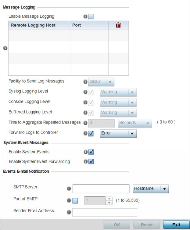

    Profile Overrides - Management - Settings Configuration Screen
  4. In the Message Logging field, select the Enable Message Logging checkbox to enable message logging. When enabled, system events are logged to a log file or a syslog server.
    Selecting this check box enables the rest of the parameters required to define the profile‘s logging configuration. This option is disabled by default.
  5. In the Remote Logging Host table provide the following:
    Remote Logging Host
    Define numerical (non DNS) IP addresses for up to four external resources where logged system events can be sent by the access point. Select the trash icon as needed to remove an IP address from the list.
    Port
    Define the ports at which the external resources are reachable.
  6. Configure the following Message Logging parameters:
    Facility to Send Log Messages
    Use the drop-down menu to specify the local server (if used) for access point event log transfers.
    System Logging Level
    Event severity coincides with the syslog logging level defined for the profile. Assign a numeric identifier to log events based on criticality. Severity levels include: 0 - Emergency, 1 - Alert, 2 - Critical, 3 - Errors, 4 - Warning, 5 - Notice, 6 - Info and 7 - Debug. The default logging level is 4 - Warning.
    Console Logging Level
    Buffered Logging Level
    Time to Aggregate Repeated Messages
    Define the increment (or interval) system events are logged on behalf of the access point. The shorter the interval, the sooner the event is logged. Either define an interval in seconds (0 - 60) or minutes (0 -1). The default value is 0 seconds.
    Forward Logs to Controller
    Select this option to define a log level for forwarding event logs to the control. Log levels include Emergency, Alert, Critical, Error, Warning, Notice, Info and Debug. The default logging level is Error.
  7. Refer to the System Event Messages field to define or override how system messages are logged and forwarded on behalf of the profile.
    1. Select Enable System Events to allow the profile to capture system events and append them to a log file.
      It is important to log individual events to discern an overall pattern that may be negatively impacting performance. This setting is enabled by default.
    2. Select Enable System Event Forwarding to enable the forwarding of system events.
  8. Refer to the Events E-mail Notification field to define or override how system event notification emails are sent.
    SMTP Server
    Specify either the hostname or IP address of the outgoing SMTP server where notification emails are originated.
    Port of SMTP
    If a non-standard SMTP port is used on the outgoing SMTP server, select this option and specify a port from 1 - 65,535 for the outgoing SMTP server to use.
    Sender E-mail Address
    Specify the email address from which notification email is originated. This is the from address on notification email.
    Recipient's E-mail Address
    Specify one or more email addresses to be the recipients of event email notifications.
    Username for SMTP Server
    Specify the username of the sender on the outgoing SMTP server. Many SMTP servers require users to authenticate with an username and password before sending email through the server.
    Password for SMTP Server
    Specify password associated with the username of the sender on the outgoing SMTP server. Many SMTP servers require users to authenticate with an username and password before sending email through the server.
