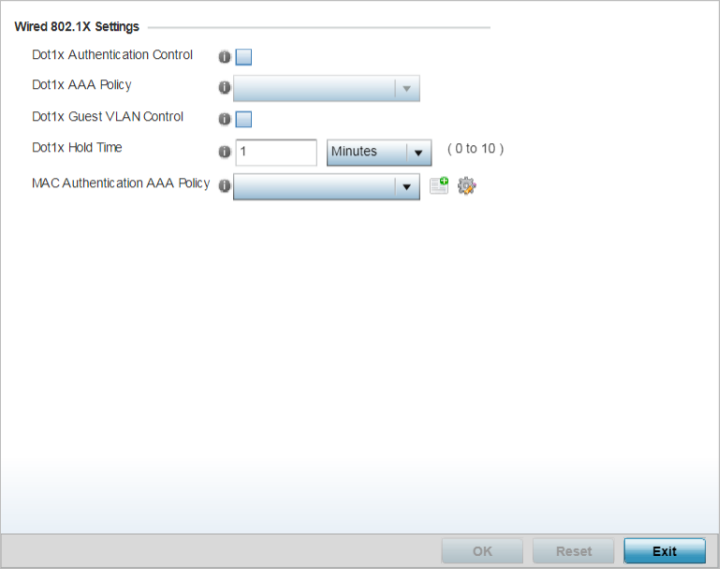

To configure the Wired 802.1x settings:
The selected access point's configuration menu displays, with the Basic configuration screen selected by default.
The Wired 802.1X Settings configuration screen displays.
| Dot1x Authentication Control | Select this option to globally enable 802.1x authentication for the access point. This setting is disabled by default. |
| Dot1x AAA Policy | Use the drop-down menu to select an AAA policy to associate with the wired 802.1x traffic. If a suitable AAA policy does not exist, click the Create icon to create a new policy or the Edit icon to modify an existing policy. |
| Dot1x Guest VLAN Control | Select this option to globally enable 802.1x guest VLANs for the selected device. This setting is disabled by default. |
| Dot1x Hold Time | Set a hold time value (after the last hello packet) in either Seconds (0 - 600) or Minutes (0 - 10). When exceeded, the controller‘s 802.1X enabled port and its destination end-point connection is defined as lost and the connection must be re-established. |
| MAC Authentication AAA Policy | Use the drop-down menu to select an AAA authentication policy for MAC address authentication. If a suitable MAC AAA policy does not exist, click the Create icon to create a new policy or the Edit icon to modify an existing policy. |
