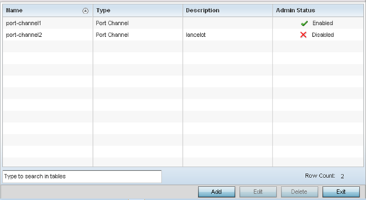

To define a port channel configuration for a device profile:
Select Configuration → Devices → System Profile from the web UI.
A list of device profiles is displayed in the right-hand UI. This list contains default and user-defined profiles.
The profile's configuration menu is displayed.
| Name | Displays the port channel's numerical identifier assigned to it when it was created. The numerical name cannot be modified as part of the edit process. |
| Type | Displays whether the type is port channel. |
| Description | Lists a short description (64 characters maximum) describing the port channel or differentiating it from others with similar configurations. |
| Admin Status | A green checkmark defines the listed port channel as active and currently enabled with the profile. A red "X" defines the port channel as currently disabled and not available for use. The interface status can be modified with the port channel configuration as required. |
