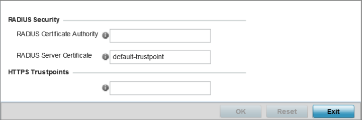

    Security - RADIUS Truspoint screen
  4. Set the following RADIUS Security certificate settings:
    RADIUS Certificate Authority Either use the default-trustpoint or select the Stored radio button to enable a drop-down menu where an existing certificate can be leveraged. To leverage an existing certificate, select the Launch Manager button.
    RADIUS Server Certificate Either use the default-trustpoint or select the Stored radio button to enable a drop-down menu where an existing certificate/trustpoint can be used. To leverage an existing trustpoint, select the Launch Manager button.
  5. Set the following HTTPS Trustpoints certificate settings:
    HTTPS Trustpoint Either use the default-trustpoint or click Stored to enable a drop-down menu where an existing certificate/trustpoint can be used. To use an existing certificate for this device, click Launch Manager. For more information, see Certificate Management.
  6. Click OK to save the changes made in the RADIUS Trustpoints screen.
