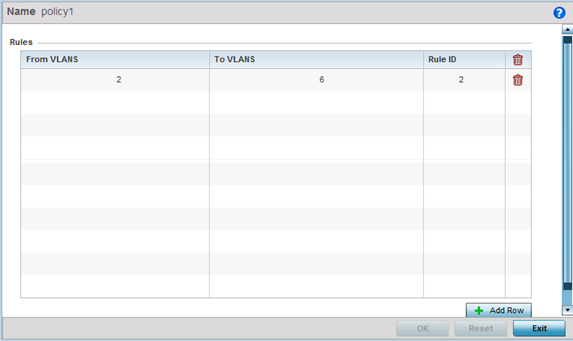

    The screen displays the name of existing Bonjour forwarding policies.
    Bonjour Gateway - Forwarding Policy Screen

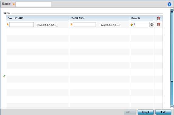

  3. Select an existing policy and select Edit to modify its configuration or select Add to create a new configuration..
    Bonjour Gateway - Forwarding Policy - Add Screen
  4. Select the + Add Row button to add a forwarding rule to the Bonjour Forwarding Policy.
    Advertisements from VLANs that contain services are forwarded to VLANs containing clients.
    From VLANs From VLANs are virtual interfaces where the Apple services are available. Enter a VLAN ID or a range of VLANs. Aliases can also be used.
    To VLANs To VLANs are virtual interfaces where clients for the services are available. Enter a VLAN ID or a range of VLANs. Aliases can also be used.
    Rule ID Use the spinner to set a unique rule ID (from 1 - 16) for this rule. This acts as numerical differentiator from other indexes.
