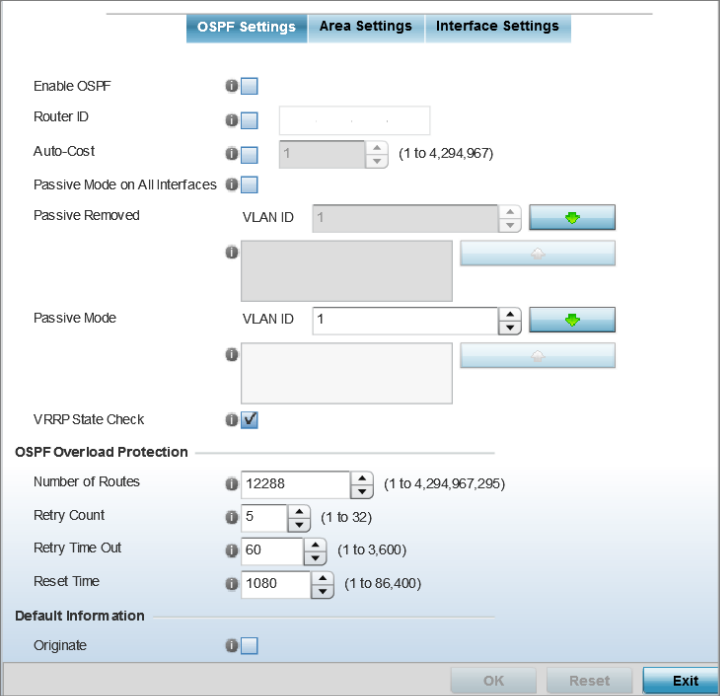

    The OSPF → OSPF Settings configuration screen displays.
    Profile Overrides - OSPF Settings Configuration Screen
  4. Select the Enable OSPF check box, and provide the following dynamic routing settings:
    Router ID
    Select this option to define a router ID (numeric IP address). This ID must be established in every OSPF instance. If not explicitly configured, the highest logical IP address is duplicated as the router identifier. However, since the router identifier is not an IP address, it does not have to be a part of any routable subnet in the network.
    Auto-Cost
    Select this option to specify the reference bandwidth (in Mbps) used to calculate the OSPF interface cost if OSPF is either STUB or NSSA. The default setting is 1.
    Passive Mode on All Interfaces
    When selected, all layer 3 interfaces are set as an OSPF passive interface. This setting is disabled by default.
    Passive Removed
    If enabling Passive Mode on All Interfaces, use the spinner control to select VLANs (by numeric ID) as OSPF non passive interfaces. Multiple VLANs can be added to the list.
    Passive Mode
    If disabling Passive Mode on All Interfaces, use the spinner control to select VLANs (by numeric ID) as OSPF passive interfaces. Multiple VLANs can be added to the list.
    VRRP State Check
    Select this option to enable checking of VRRP state. If the interface‘s VRRP state is not Backup, then the interface is published via OSPF.
  5. Set the following OSPF Overload Protection parameters:
    Number of Routes
    Use the spinner controller to set the maximum number of OSPN routes permitted. The available range is from 1 - 4,294,967,295.
    Retry Count
    Set the maximum number of retries (OSPF resets) permitted before the OSPF process is shut down. The available range is from 1 - 32. The default setting is 5.
    Retry Time Out
    Set the duration (in seconds) the OSPF process remains off before initiating its next retry. The available range is from 1 - 3,600 seconds. The default is 60 seconds.
    Reset Time
    Set the reset time (in seconds) that, when exceeded, changes the retry count is zero. The available range is from 1 - 86,400. The default is 360 seconds.
  6. Set the following Default Information:
    Originate
    Select this option to make the default route a distributed route. This setting is disabled by default.
    Always
    Enabling this setting continuously maintains a default route, even when no routes appear in the routing table. This setting is disabled by default.
    Metric Type
    Select this option to define the exterior metric type (1 or 2) used with the default route.
    Route Metric
    Select this option to define route metric used with the default route. OSPF uses path cost as its routing metric. It‘s defined by the speed (bandwidth) of the interface supporting a given route.
  7. In the Route Redistribution table, click + Add Row and set the types of routes that can be used by OSPF.
    Route Type
    Set the Route Type used to define the redistributed route. Options include: connected, kernel and static.
    Metric Type
    Select this check box, and define the exterior metric type (1 or 2) used with the route redistribution.
    Metric
    Select this option, and define route metric used with the redistributed route.
  8. In the OSPF Network table, click +Add Row and configure the following:
    Network
    Add the IP address and mask of the Network(s) participating in OSPF.
    Area ID
    Define the OSPF area (IP address) to which the network belongs.
  9. In the Clear OSPF Process, click Clear to clear all OSPF Routing table entries.
  10. Set an OSPF Default Route Priority (1 - 8,000) as the priority of the default route learnt from OSPF. The default priority is 7000.
  11. Click OK to save the OSPF setting changes.
