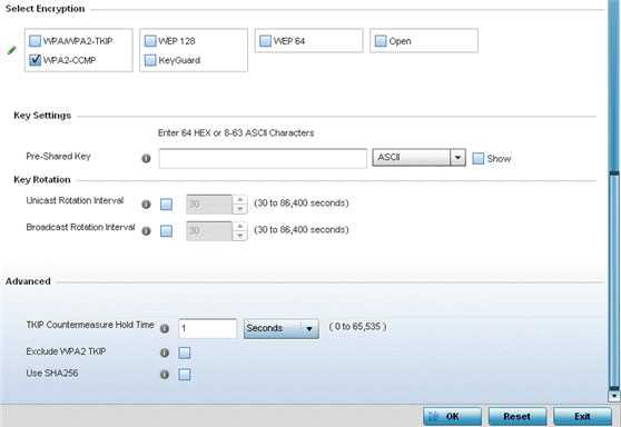

  4. Select the WPA2-CCMP check box from within the Select Encryption field.
    The screen populates with the parameters required to define a WPA2-CCMP configuration for the new or existing WLAN.
    WLAN Security - WPA2-CCMP Screen
  5. Define Key Settings.
    Pre-Shared Key Enter either an alphanumeric string of 8 to 63 ASCII characters or 64 HEX characters as the primary string both transmitting and receiving authenticators must share. The alphanumeric string allows character spaces. The string is converetd to to a numeric value. This passphrase saves the administrator from entering the 256-bit key each time keys are generated.
  6. Define Key Rotation values.
    Unicast messages are addressed to a single device on the network. Broadcast messages are addressed to multiple devices. When using WPA2, a wireless client can use two keys: one unicast key, for its own traffic to and from an Access Point, and one broadcast key, the common key for all the clients in that subnet.
    Rotating the keys is recommended the keys so a potential hacker would not have enough data using a single key to attack the deployed encryption scheme.
    Unicast Rotation Interval Define an interval for unicast key transmission interval from 30 - 86,400 seconds. Some clients have issues using unicast key rotation, so ensure you know which kind of clients are impacted before using unicast keys. This feature is disabled by default.
    Broadcast Rotation Interval When enabled, the key indices used for encrypting and decrypting broadcast traffic is alternatively rotated based on the defined interval. Define a broadcast key transmission interval from 30 - 86,400 seconds. Key rotation enhances the broadcast traffic security on the WLAN. This feature is disabled by default.

  8. Set the following Advanced settings for the WPA2-CCMP encryption scheme:
    TKIP Countermeasure Hold Time The TKIP Countermeasure Hold Time is the time a WLAN is disabled, if TKIP countermeasures have been invoked on the WLAN. Use the drop-down menu to define a value in either Hours (0-18), Minutes (0-1,092) or Seconds (0-65,535). The default setting is 1 second.
    Exclude WPA2-TKIP Select this option to advertise and enable support for only WPA-TKIP. This option can be used if certain older clients are not compatible with newer WPA2-TKIP information elements. Enabling this option allows backwards compatibility for clients that support WPA-TKIP and WPA2-TKIP, but do not support WPA2-CCMP. We recommend that you enable this feature if WPA-TKIP or WPA2-TKIP supported clients operate in a WLAN populated by WPA2- CCMP enabled clients. This feature is disabled by default.
    Use SHA256
    Select this option to enable SHA-256 authentication key management suite. This suite consists of a set of algorithms for key agreement, key derivation, key wrapping, and content encryption and provide a minimum cryptographic security level of 128 bits. This feature is disabled by default.
  9. Select OK when completed to update the WLAN's WPA2-CCMP encryption configuration.
    Select Reset to revert to the last saved configuration.
