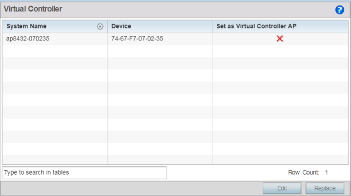

  1. Select Configuration → Devices → Virtual Controller.
    Virtual Controller Screen
  2. This Virtual Controller screen lists all peer access points within this Virtual Controller‘s radio coverage area. Each listed access point is listed by its assigned System Name, MAC Address and Virtual Controller designation.
  3. Either select an access point from those displayed and select Edit, or use the device browser in the lower left-hand side of the UI to select an access point.

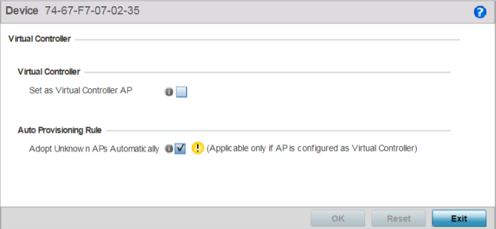

    Managing Virtual Controller - AP Designation Screen
  4. Select the Set as Virtual Controller AP radio button to change the selected access point‘s designation from Standalone to Virtual Controller AP. Remember, only one Virtual Controller can manage (up to) 64 access points of the same model. Thus, an administrator should take care to change the designation of a Virtual Controller AP to Standalone AP to compensate for a new Virtual Controller AP designation.
  5. Click OK to save the changes.
