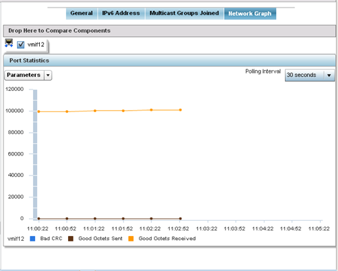

The Network Graph displays statistics the access point continuously collects for its interfaces. Even when the interface statistics graph is closed, data is still collected. Display the interface statistics graph periodically for assessing the latest interface information. Up to three different stats can be selected and displayed within the graph.
To view a detailed graph for an interface, select an interface and drop it on to the graph. The graph displays Port Statistics as the Y-axis and the Polling Interval as the X-axis. Use the Polling Interval from-down menu to define the increment data is displayed on the graph.
To view the Interface Statistics graph:
Procedure
  1. Select the Statistics menu from the Web UI.
  2. Expand the System node from the navigation pane (on the left-hand side of the screen).
    The System node expands to display the RF Domains created within the managed network.
  3. Expand an RF Domain node, and select one of it's connected access points.
    The Access Point's statistics menu displays in the right-hand side of the screen, with the Health tab selected by default.
  4. Select the Interfaces > Network Graph tab.
    The Statistics > AP > Interfaces > Network Graph screen displays in the right-hand pane.
  5. Use the Parameters drop-down menu to specify what is trended in the graph.
