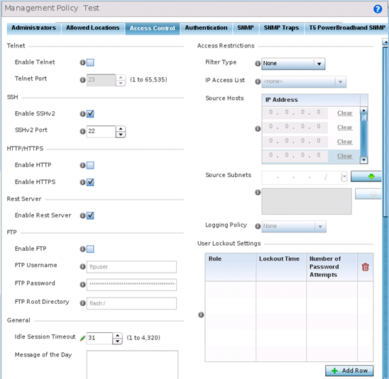

Setting the Access Control Configuration
About this task
Refer to the Access Control screen to allow/deny management access to the network using strategically selected protocols (HTTP, HTTPS, Telnet, SSH or SNMP). Access options can be either enabled or disabled as required. Consider disabling unused interfaces to close unnecessary security holes. The Access Control tab is not meant to function as an ACL (in routers or other firewalls), where you can specify and customize specific IPs to access specific interfaces.

To set an access control configuration for the Management Access policy:
Procedure
  1. Select the Access Control tab.
  2. Set the following parameters required for Telnet access:

  3. Set the following parameters required for SSH access:
    Enable SSHv2 Select the checkbox to enable SSH device access. SSH (Secure Shell) version 2, like Telnet, provides a command line interface to a remote host. SSH transmissions are encrypted and authenticated, increasing the security of transmission. SSH access is disabled by default.

  4. Set the following HTTP/HTTPS parameters:
    Enable HTTP Select the check box to enable HTTP device access. HTTP provides limited authentication and no encryption.
    Enable HTTPS Select the check box to enable HTTPS device access. HTTPS (Hypertext Transfer Protocol Secure) is more secure than plain HTTP. HTTPS provides both authentication and data encryption as opposed to just authentication.

  5. Set the following parameters required for FTP access:
    Enable FTP Select the check box to enable FTP device access. FTP (File Transfer Protocol) is the standard protocol for transferring files over a TCP/IP network. FTP requires administrators enter a valid username and password authenticated locally on the controller. FTP access is disabled by default.

  6. Set the following General parameters:
    Idle Session Timeout Specify an inactivity timeout for management connects (in seconds) between 1 - 4,320. The default setting is 12.0

  7. Set the following Access Restrictions parameters:
    Filter Type Select a filter type for access restriction. Options include IP Access List, Source Address or None. To restrict management access to specific hosts, select Source Address as the filter type and provide the allowed addresses within the Source Hosts field.

  8. Click OK to save the Access Control configuration or click Reset to revert to the last saved configuration.
