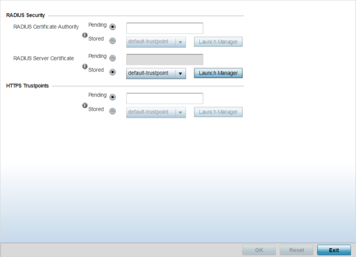

    The trustpoints configuration screen displays.
    Trustpoints Configuration Screen
  4. Set the following RADIUS Security certificate settings:
    RADIUS Certificate Authority
    Select Pending to use a certificate that is in the process of being created or is yet to be created. As such certificates will not be listed under the Stored drop-down, use this method instead. Using this option is not a guarantee that the trust point will work as intended if the trust point is not loaded on to the device. The trust point can be created later, however, it must be present on the device when the device is deployed.
    Select Stored to enable a drop-down menu where an existing certificate can be leveraged or use default-trustpoint. To leverage an existing certificate, click the Launch Manager button.
    RADIUS Server Certificate
    Select Pending radio button to use a certificate that is in the process of being created or is yet to be created. As such certificates will not be listed under the Stored drop-down, use this method instead. Using this option is not a guarantee that the trust point will work as intended if the trust point is not loaded on to the device. The trust point can be created later, however, it must be present on the device when the device is deployed.
  5. In the HTTPS Trustpoints field, set the following parameters:
    HTTPS Trustpoint
    Select Stored to enable a drop-down menu where an existing certificate/trustpoint can be used. where an existing certificate can be leveraged or use default-trustpoint. To leverage an existing certificate, click the Launch Manager button. For more information, see Certificate Management.
  6. Click OK to save the RADIUS Trustpoints configuration overrides.
