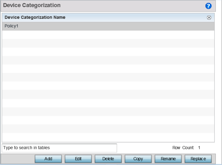

  1. Select Configuration > Security > Device Configuration to display existing device categorization policies.
    The Device Categorization screen lists the device authorizations defined thus far.
  2. Select Add to create a new Device Categorization policy, Edit to modify the attributes of a selected policy or Delete to remove obsolete policies from the list of those available.

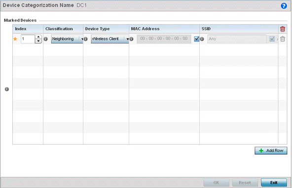

    Device Categorization Screen - Marked Devices
  3. If you are creating a new Device Categorization filter, give it a Name (up to 32 characters).
    Select OK to save the name and enable the remaining device categorization parameters.
  4. Select + Add Row to populate the Marked Devices field with parameters for classifying an access point or client and defining the target device‘s MAC address and SSID.
    Select the red (-) Delete Row icon as needed to remove an individual table entry.
  5. Refer to Thresholds field to set the thresholds used as filtering criteria.
    Index Use the spinner control to designate a index value to this entry. Use a value in the range 1 - 1000.
    Classification Use the drop-down menu to designate the target device as either Sanctioned or Neighboring.
    Device Type Use the drop-down menu to designate the target device as either an access point or client.
    MAC Address Enter the factory coded MAC address of the target device. This address is hard coded by the device manufacturer and cannot be modified. This MAC address is defined as authorized or unauthorized as part of the device categorization process.
    SSID Enter the SSID of the target device requiring categorization. The SSID cannot exceed 32 characters.
  6. Select OK to save the updates to the Marked Devices list.
