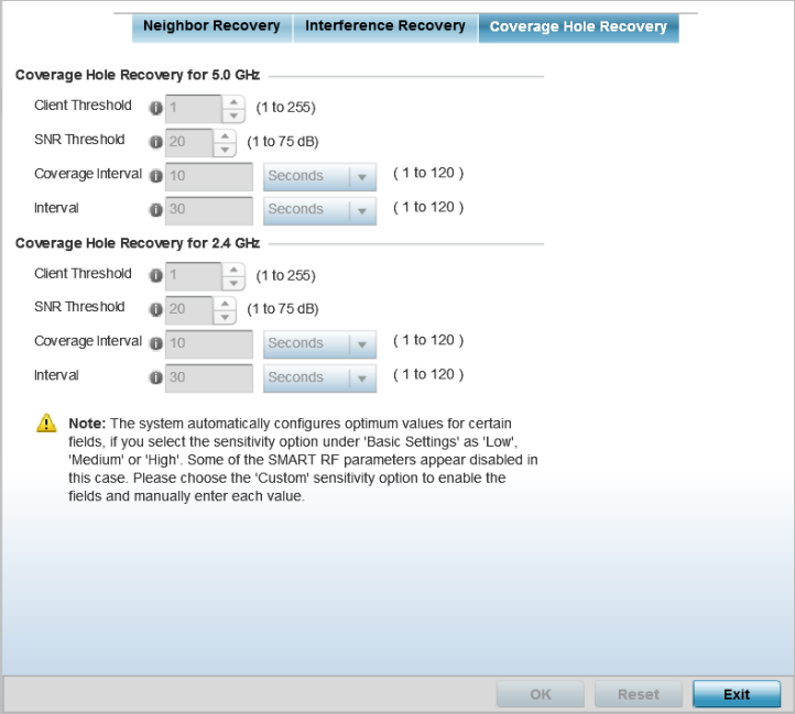

  1. Select Coverage Hole Recovery.
    SMART RF - Advanced Configuration Screen - Coverage Hold Recovery Tab
  2. Set the following Coverage Hole Recovery for 2.4 GHz and 5.0 GHz parameters:
    Client Threshold Use the spinner to set a client threshold for the Smart RF policy between 1 - 255. This is the minimum number of clients a radio should have associated in order for coverage hole recovery to trigger. The default setting is 1.
    SNR Threshold Set a signal-to-noise (SNR) threshold , between 1 - 75 dB. This is the signal-to-noise threshold for an associated client as seen by its associated access point radio. When exceeded, the radio increases its transmit power in order to increase coverage for the associated client. The default value is 20 dB.
    Coverage Interval Define the length of time after which coverage hole recovery should be initiated when a coverage hole is detected. The default is 10 seconds for both the 2.4 and 5.0 GHz radios.
    Interval Define the length of time coverage hole recovery should be conducted before a coverage hole is detected. The default is 30 seconds for both the 2.4 and 5.0 GHz radios.
  3. Click OK to update the Smart RF Coverage Hole Recovery settings for this policy.
