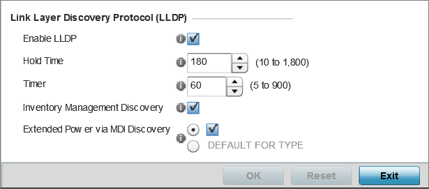

    Network - Link Layer Discovery Protocol (LLDP) screen
  4. Set the following LLDP parameters for the profile configuration:
    Enable LLDP Select this option to enable LLDP on the access point. LLDP is enabled by default When enabled, an access point advertises its identity, capabilities and configuration information to connected peers and learns the same from them.
    Hold Time Use the spinner control to set the hold time (in seconds) for transmitted LLDP PDUs. Set a value from 10 - 1,800. The default hold time is 180 seconds.
    Timer Set the interval used to transmit LLDP PDUs. Define an interval from 5 - 900 seconds. The default setting is 60 seconds.
    Inventory Management Discovery Select this option to include LLPD-MED inventory management discovery TLV in LLDP PDUs. This setting is enabled by default.
    Extended Power via MDI Discovery Select this option to include LLPD-MED extended power via MDI discovery TLV in LLDP PDUs. This setting is disabled by default.
  5. Select OK to save the LLDP configuration changes.
    Select Reset to revert to the last saved configuration.
