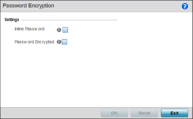

    The Password Encryption screen displays.

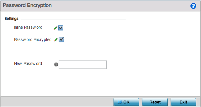

    Configuration - Devices - Password Encryption Screen
  3. Select the Inline Password option.
    The inline password option moves the encryption key to the startup-config file. By default, the encryption key is not stored in the startup-config file.
  4. Select the Password Encrypted option.
    The New Password field is enabled.
    Configuration - Devices - Password Encryption - New Password Field
  5. Enter the secret phrase in the New Password field. The system uses this phrase to encrypt passwords.
  6. Click OK to save password encryption configuration.
