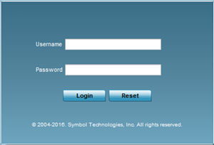

  3. Once obtained, point the Web browser to the access point‘s IP address. The following login screen displays:
    The Web UI login dialog displays:
    Web UI Login Screen
  4. Enter the default username admin in the Username field.
  5. Enter the default password admin123 in the Password field.
    When logging in for the first time, you will be prompted to change the password to enhance device security. Set the new password and use it for subsequent logins.
  6. Click the Login button to load the device's (access point, wireless controller or service platform) management interface.

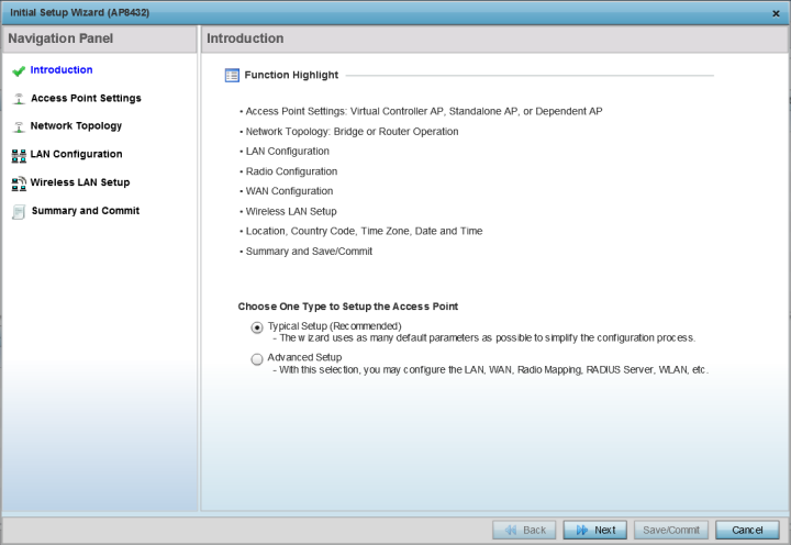

    If you are powering-up the AP for the first time, the AP's management UI opens, and the Initial Setup Wizard dialog pops up. Use this wizard to configure the basic settings required to get the AP up and running. For more information on using the Initial Setup Wizard, see Using the Initial Setup Wizard.
    The AP's Initial Setup Wizard:
    The Initial Setup Wizard
