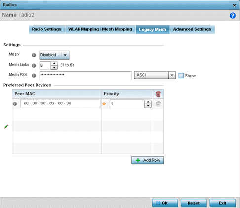

WiNG 7.x.x release does not support MeshConnex on AP3xx, AP4xx, and AP5xx model access points. This feature will be supported in future releases.To set/override a radio's legacy mesh configuration:
| Mesh | Use the drop-down menu to set the mesh mode for this radio. Available options are Disabled, Portal or Client. Setting the mesh mode to Disabled deactivates all mesh activity on this radio. Setting the mesh mode to Portal turns the radio into a mesh portal. This will start the radio beaconing immediately and accept connections from other mesh nodes. Setting the mesh mode to client enables the radio to operate as a mesh client and scan and connect to mesh portals or nodes connected to portals. |
| Mesh Links | Specify the number of mesh links allowed by the radio. The radio can have between 1-6 mesh links when the radio is configured as a Portal or Client. |
| Mesh PSK | Provide the encryption key in either ASCII or Hex format.
Administrators must ensure this key is configured on the access point
when staged for mesh, added to the mesh client and to the portal
access point‘s configuration on the controller or service platform.
Select Show to expose the characters used in the PSK. Note: Only single hop mesh
links are supported at this time.
Note: The mesh encryption
key is configurable from the CLI using the command '
mesh →
psk'. Administrators must ensure this key is configured
on the AP when it is being staged for mesh, and also added to the
mesh client as well as to the portal APs configuration on the
controller. |
| Priority | Use this spinner control to set a priority (1 -6) for connection preference. |
| Peer MAC | For each priority value, define the MAC address of the associated peer device. Use this option to are define MAC addresses representing peer devices for the radio to connect to in mesh mode. |
