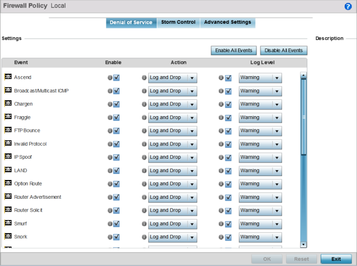

The Wireless Firewall screen has Denial of Service, Storm Control, and Advanced Settings tabs used to create the single firewall policy used by the access point and its connected devices. The Denial of Service tab displays by default.

  1. Got o Configuration → Security → Wireless Firewall .
    Wireless Firewall Screen - Denial of Service Tab
  2. Select the Activate Firewall Policy option on the upper left-hand side of the screen to enable the screen‘s parameters for configuration.
    Ensure that this option stays selected to apply the configuration to the access point profile.
    The Settings field lists all of the DoS attacks for which the firewall has filters. Each DoS filter contains the following four items:
    Event Lists the name of each DoS attack.
    Enable Select Enable to set the firewall to filter the associated DoS attack based on the selection in the Action column.
    Action If a DoS filter is enabled, choose an action from the drop-down menu to determine how the firewall policy treats the associated DoS attack.
    • Log and Drop - An entry for the associated DoS attack is added to the log and then the packets are dropped.
    • Log Only - An entry for the associated DoS attack is added to the log. No further action is taken.
    • Drop Only - The DoS packets are dropped. No further action is taken.
    Log Level Select this option to enable logging to the system log. Then select a standard Syslog level from the Log Level drop-down menu.
  3. The following Events can be filtered on behalf of the firewall:

  4. Select OK to update the Denial of Service settings.
    Select Reset to revert to the last saved configuration. The firewall policy can be invoked at any point in the configuration process by selecting Activate Firewall Policy from the upper left-hand side of the access point user interface.
