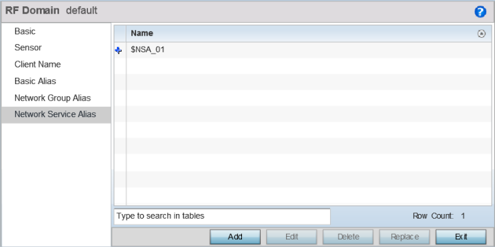

  1. Go to Configuration → Devices.
  2. Select an RF Domain from the options on left-hand side of the UI, and then go to the Network Service Alias tab.
    The screen displays network service aliases existing within the managed system.
    RF Domain - Network Service Alias screen
