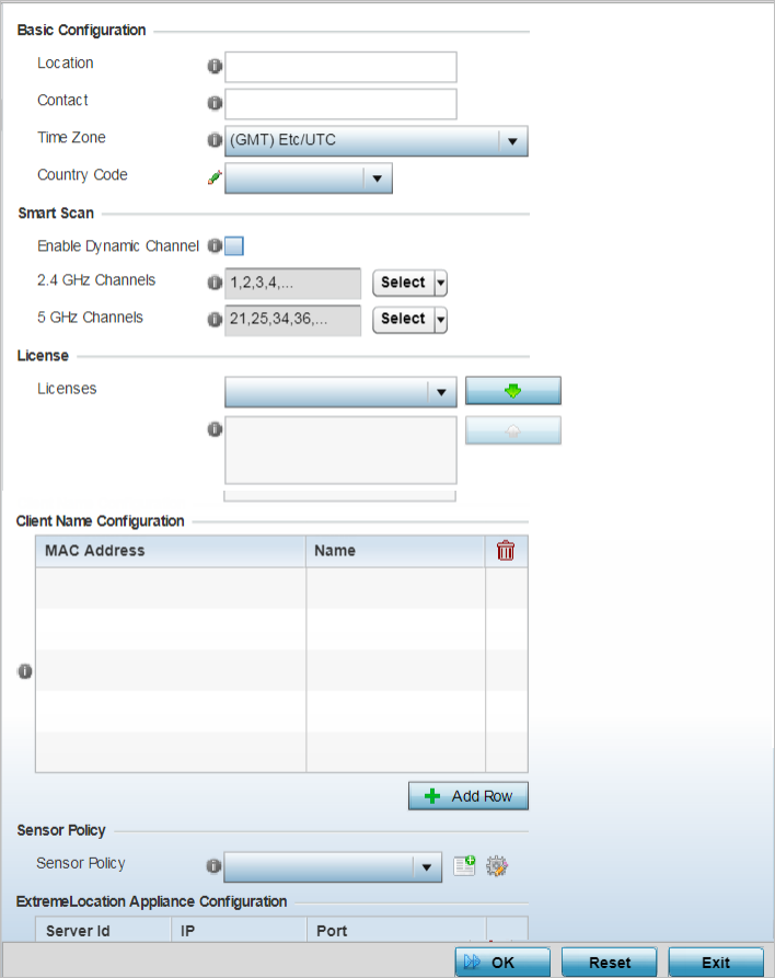

A blue override icon (to the left of a parameter) defines the parameter as having an override applied. To remove a device‘s override, go to the Basic Configuration screen‘s Device Overrides field, and then select the Clear Overrides button.| Location | Set the deployment location for the access point as part of its RF Domain configuration |
| Contact | Set the administrative contact for the access point. This should reflect the administrator responsible for the access point‘s configuration and wireless network. |
| Time Zone | Use the drop-down menu to select the geographic time zone supporting its deployment location |
| Country Code | Use the drop-down menu to select the country code supporting its deployment location |
| Enable Dynamic Channel | Select this option to enable dynamic channel scan. |
| 2.4 GHz Channels | Use the Select drop-down menu to select channels to scan in the 2.4 GHz band. Selected channels are highlighted with a gray background. Unselected channels are highlighted with a white background. Multiple channels can be selected at the same time |
5.0 GHz Channels |
Use the Select drop-down menu to select channels to scan in the 5.0 GHz band. Selected channels are highlighted with a gray background. Unselected channels are highlighted with a white background. Multiple channels can be selected at the same time |
If a dedicated sensor is utilized with WIPS for rogue detection, any sensor policy selected from the Sensor Policy drop-down menu is discarded and not utilized by the sensor. To avoid this situation, use ADSP channel settings exclusively to configure the sensor and not the WiNG interface.Select the Create icon to create a new sensor policy to apply to this RF Domain or select the Edit icon to update the configuration of an existing policy before applying it to the RF Domain. For more information, see Sensor Policy.
ExtremeLocation is a highly scalable indoor locationing platform that gathers location-related analytics, such as visitor trends, peak and off-peak times, dwell time, heat-maps, etc. to enable entrepreneurs deeper visibility at a venue. To enable the location tracking system, the ExtremeLocation server should be up and running and the RF Domain configuration should point to the ExtremeLocation server.
| Server Id | Use the spinner control to assign a numerical ID for the
ExtremeLocation server resource. Note: As of now
only one server is supported.
| IP Address/Hostname | Provide the hostname of the ExtremeLocation server
resource for receiving RSSI scan data from the AP. Hostname
cannot exceed 64 characters or contain an underscore. Note: Enter the
ExtremeLocation server‘s hostname and not the IP
address, as the IP address is likely to change
periodically in order to balance load across multiple
Location server instances.
| Port | Use the spinner control to specify the port of the
ExtremeLocation server resource receiving RSSI scan data.
Note: By
default, the ExtremeLocation server is reachable on port
443.
