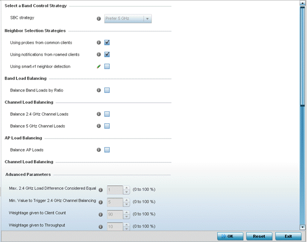

  3. Expand the Advanced menu and select Client Load Balancing.
    Profile Overrides - Client Load Balancing Screen
  4. Use the Group ID field to define a group ID of up to 32 characters to differentiate this profile from others with similar configurations.
  5. Use the SBC strategy drop-down menu to determine how band steering is conducted.
    Options include Prefer 5GHz, Prefer 2.4 GHz and distribute-by-ratio. The default value is Prefer 5GHz.

  6. Set the following Neighbor Selection Strategies:
    Using Probes from common clients
    Select this option to select neighbors (peer devices) using probes from common clients. This option is enabled by default.
    Using Notifications from roamed clients
    Select this option to select neighbors (peer devices) using roam notifications from roamed clients. This option is enabled by default.
    Using smart-rf neighbor detection
    Select this option to select neighbors (peer devices) using the Smart RF neighbor detection algorithm. This option is enabled by default.
