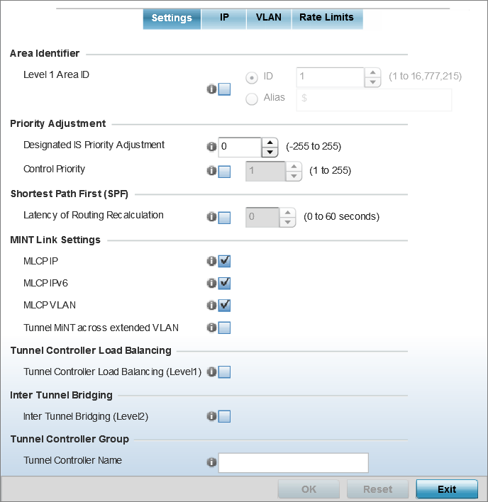

  1. Select MINT Protocol.
    The MiNT Settings tab displays by default.
    Profile Overrides - Advanced MiNT Settings Configuration Screen
  2. In the Area Identifier field, define or override the Level 1 and Level 2 Area IDs used by the profile‘s MiNT configuration.
    Level 1 Area ID
    Select this option to enable a spinner control for setting the Level 1 Area ID from 1 - 16,777,215. The default value is disabled. Alternatively, provide an alias by selecting the Alias option and adding the alias name to this field.
  3. In the Priority Adjustment field, set or override the following settings:
    Designated IS Priority Adjustment
    Use the spinner control to set a Designated IS Priority Adjustment setting from -255 - +255. This is the value added to the base level DIS priority to influence the DIS (Designated IS) election. A value of +1 or greater increases DISiness. The default setting is 0.
    Control Priority
    Select to set the priority of this device with respect to others, within the network, in being selected as the Level 2 router. Higher the value, higher is the chances of the device of becoming the Level 2 router.

  4. In the Shortest Path First (SPF) field, select the Latency of Routing Recalculation option to enable the spinner control used for defining or overriding a latency period (from 0 - 60 seconds).

  5. Define or override the following MiNT Link Settings:
    MLCP IP
    Select this option to enable MLCP (MiNT Link Creation Protocol) by IP Address. MLCP is used to create a UDP/IP link from the device to a neighbor.
    The neighboring device can be another AP.
    Note:
    This option is enabled by default.
    MLCP IPv6
    Select this option to enable MLCP by IPv6 Address. MLCP by IPv6 is used to create one UDP/IP link from the device to a neighbor. The neighboring device does not need to be a virtual controller; it can be an standalone access point.
    Note:
    MLCP VLAN
    Select this option to enable MiNT MLCP by VLAN. MLCP is used to create one VLAN link from the device to a neighbor.
    Note:
    Tunnel MiNT across extended VLAN
    Select this option to tunnel MiNT protocol packets across an extended VLAN.
    Note:
    This option is disabled by default.
  6. Select Tunnel Controller Load Balancing (Level 1) to enable load balancing through a WLAN tunnel controller.
  7. In the Inter Tunnel Bridging field, select Inter Tunnel Bridging (Level 2) to enable inter tunnel bridging.
  8. In the Tunnel Controller Group field, enter a 64-character maximum Tunnel Controller Name for this tunneled-WLAN-controller interface.
