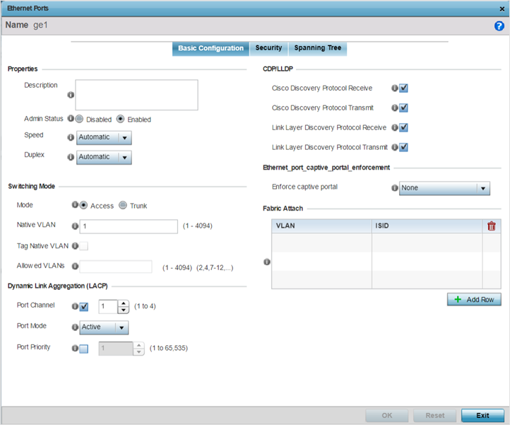

Configure Basic Ethernet Port Settings
To define a profile's Ethernet port basic configuration:
  1. To edit the configuration of an existing port, select it from amongst those displayed and select the Edit button. The Ethernet port Basic Configuration screen displays by default.
  2. Set the following Ethernet port Properties:

  3. Enable or disable the following CDP/LLDP parameters used to configure Cisco Discovery Protocol and Link Layer Discovery Protocol for this profile's Ethernet port configuration:

  4. Define the following Switching Mode parameters to apply to the Ethernet port configuration:

  5. In the Dynamic Link Aggregation (LACP) area, set the following parameters to enable link aggregation on the selected GE port:

  6. Select a Captive Portal Enforcement option for the selected Ethernet port interface.

  7. Click + Add Row and set or override the Fabric Attach parameters. This option enables WiNG devices (access points and controllers) as FA (Fabric Attach) Clients.

  8. Optionally select the Port Channel checkbox and define a setting between 1 - 3 using the spinner control. This sets the channel group for the port.
  9. Select OK to save the changes made to the Ethernet Port Basic Configuration. Select Reset to revert to the last saved configuration.
