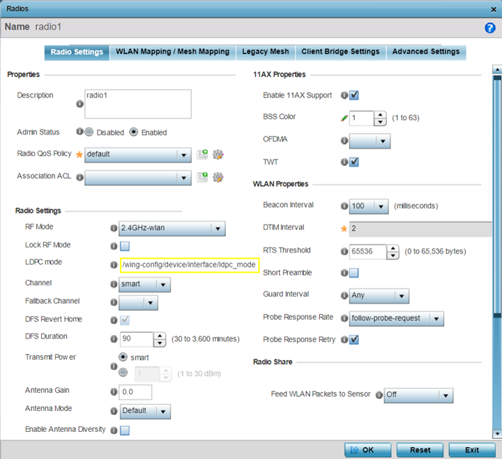

To edit an access point's radio settings:
The Radio Settings tab displays by default.
| Description | Provide or edit a description (1 - 64 characters in length) for the radio that helps differentiate it from others with similar configurations. |
| Admin Status | Select the Enabled radio button to define this radio as active to the profile it supports. Select the Disabled radio button to disable this radio configuration within the profile. It can be activated at any future time when needed. The default setting is enabled. |
| Radio QoS Policy | Use the drop-down menu to specify an existing QoS policy to apply to the access point radio in respect to its intended radio traffic. If there's no existing suiting the radio's intended operation, select the Create icon to define a new QoS policy that can be applied to this profile. |
| Association ACL | Use the drop-down menu to specify an existing Association ACL policy to apply to the access point radio. An Association ACL is a policy-based ACL that either prevents or allows wireless clients from connecting to an access point radio. An ACL is a sequential collection of permit and deny conditions that apply to packets. When a packet is received on an interface, its compared against applied ACLs to verify the packet has the required permissions to be forwarded. If a packet does not meet any of the criteria specified in the ACL, the packet is dropped. Select the Create icon to define a new Association ACL that can be applied to this profile. |
| RF Mode | The radio can be configured to provide WLAN service for 2.4 GHz
and 5 GHz enabled clients. You can also set the radio to provide
sensor support, scan-ahead support, or function as a client
bridge. Set the mode to either 2.4 GHz WLAN or 5 GHz WLAN depending on the radio's intended client support requirement. Set the mode to Sensor if using the radio for rogue device detection. To set a radio as a detector, disable Sensor support on the other access point radio. Select Bridge to allow the radio to function as a client-bridge can authenticate and associate to the WLAN hosted on the infrastructure access point. if selecting this option, configure the client-bridge parameters. Refer to the Manage Client Bridge Settings topic for details. Note: For
information on the possible modes of operations for the AP410i/e, AP460i/e, AP510i/e and AP560i/h radios, click
here.
Note: For
information on the possible modes of operations for the AP505i
radios, click here.
Note: The
AP510e access point has eight, external antennas grouped into:
Group 1 (with antenna ports 1 to 4) and Group 2 (with antenna ports
5 to 8). Use the 'Antenna' option to configure the antenna-id for
the group-1 (1 to 4) or group-2 (5 to 8) antennas. For information
on configuring the antenna-id, see AP510e: External
Antenna Configurations.
Note: The
AP560h access point has eight, internal antennas, supporting
following two antenna modes: 30 degree and
70 degree.
Use the 'Antenna' option to configure the antenna-id. For
information on configuring the antenna-id, see AP510e: External
| Lock RF Mode | Select the check box to lock Smart RF for this radio. The default setting is disabled. |
| DFS Revert Home | Select this option to revert to the home channel after a DFS evacuation period. |
| Channel | Use the drop-down menu to select the channel of operation for the radio. Only a trained installation professional should define the radio channel. Select Smart for the radio to scan non-overlapping channels listening for beacons from other access points. After channels are scanned, the radio selects the channel with the fewest access points. In the case of multiple access points on the same channel, it selects the channel with the lowest average power level. The default value is Smart. Channels with a “w” appended to them are unique to the 40 MHz band. Channels with a “ww” appended to them are 802.11ac specific, and are unique to the 80 MHz band. |
| Transmit Power | Set the transmit power of the selected access point radio. If using a dual or three radio model access point, each radio should be configured with a unique transmit power in respect to its intended client support function. A setting of 0 defines the radio as using Smart RF to determine its output power. 20 dBm is the default value. |
| Antenna Gain | Set the antenna between 0.00 - 15.00 dBm. The access point's Power Management Antenna Configuration File (PMACF) automatically configures the access point's radio transmit power based on the antenna type, its antenna gain (provided here) and the deployed country's regulatory domain restrictions. Once provided, the access point calculates the power range. Antenna gain relates the intensity of an antenna in a given direction to the intensity that would be produced ideally by an antenna that radiates equally in all directions (isotropically), and has no losses. Although the gain of an antenna is directly related to its directivity, its gain is a measure that takes into account the efficiency of the antenna as well as its directional capabilities. Only a professional installer should set the antenna gain. The default value is 0.00. |
| Antenna Mode | Set the number of transmit and receive antennas on the access point. 1x1 is used for transmissions over just the single "A" antenna, 1x3 is used for transmissions over the "A" antenna and all three antennas for receiving. 2x2 is used for transmissions and receipts over two antennas for dual antenna models. 3x3x3 is used for transmissions and receipts over three antennas models. The default setting is dynamic based on the access point model deployed and its transmit power settings. |
| Enable Antenna Diversity | Select this box to enable antenna diversity on supported antennas. Antenna diversity uses two or more antennas to increase signal quality and strength. This option is disabled by default. |
| Wireless Client Power | Select this option to specify the transmit power on supported wireless clients. If this is enabled set a client power level between 0 to 20 dBm. This option is disabled by default. |
| Dynamic Chain Selection | Select this option for the radio to dynamically change the number of transmit chains. This option is enabled by default. |
| Data Rates | Once the radio band is provided, the Data Rates drop-down menu
populates with rate options depending on the 2.4 or 5 GHz band
selected. If the radio band is set to Sensor or Detector, the Data
Rates drop-down menu is not enabled, as the rates are fixed and not
user configurable. If 2.4 GHz is selected as the radio band, select
separate 802.11b, 802.11g and 802.11n rates and define how they are
used in combination. If 5 GHz is selected as the radio band, select
separate 802.11a and 802.11n rates then define how they are used
together. When using 802.11n (in either the 2.4 or 5 GHz band), Set a
MCS (modulation and coding scheme) in respect to the radio's channel
width and guard interval. A MCS defines (based on RF channel
conditions) an optimal combination of 8 data rates, bonded channels,
multiple spatial streams, different guard intervals and modulation
types. Clients can associate as long as they support basic MCS (as
well as non-11n basic rates). If dedicating the radio to either 2.4 or 5 GHz support, a Custom Rates option is available to set a modulation and coding scheme (MCS) in respect to the radio's channel width and guard interval. A MCS defines (based on RF channel conditions) an optimal combination of rates, bonded channels, multiple spatial streams, different guard intervals and modulation types. Clients can associate as long as they support basic MCS (as well as non-11n basic rates). If Basic is selected within the 802.11n Rates field, the MCS0-7 option is auto selected as a Supported rate and that option is grayed out. If Basic is not selected, any combination of MCS0-7, MCS8-15 and MCS16-23 can be supported, including a case where MCS0-7 and MCS16-23 are selected and not MCS8-15. The MCS0-7 and MCS8-15 options are available to each supported access point. Refer to the bottom of this page for 802.11an and 802.11ac MCS dates rates in detail, both with and without short guard intervals (SGI). Note: For information on
supported data rates see, SUPPORTED DATA RATES
| Radio Placement | Use the drop-down menu to specify whether the radio is located Indoors or Outdoors. The placement should depend on the country of operation and its regulatory domain requirements for radio emissions. The default setting is Indoors. |
| Max Clients | Use the spinner control to set a maximum permissible number of clients to connect with this radio. The available range is between 0 - 512 clients. The default value is 512. |
| Rate Selection Method |
Specify a radio selection method for the radio. The selection methods are: Standard: standard monotonic radio selection method will be used. Opportunistic: sets opportunistic radio link adaptation as the radio selection method. This mode uses opportunistic data rate selection to provide the best throughput. |
