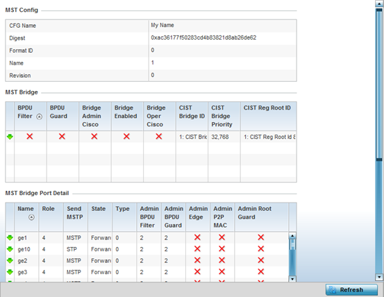

To view an access point's MSTP statistics:
Procedure
  1. Select the Statistics menu from the Web UI.
  2. Expand the System node from the navigation pane (on the left-hand side of the screen).
    The System node expands to display the RF Domains created within the managed network.
  3. Expand an RF Domain node, and select one of it's connected access points.
    The Access Point's statistics menu displays in the right-hand side of the screen, with the Health tab selected by default.
  4. Expand the Network menu from the left-hand side of the UI.
  5. Select MSTP.
    The Statistics > AP > Network > MSTP screen is displayed in the right-hand pane.
    The MST Config field displays the name assigned to the MSTP configuration, its digest, format ID, name and revision.
    The MST Bridge field lists the filters and guards that have been enabled and whether Cisco interoperability if enabled.
    The MST Bridge Port Detail field lists specific controller or service platform port status and their current state.
  6. Select Refresh to update the screen‘s statistics counters to their latest values.
