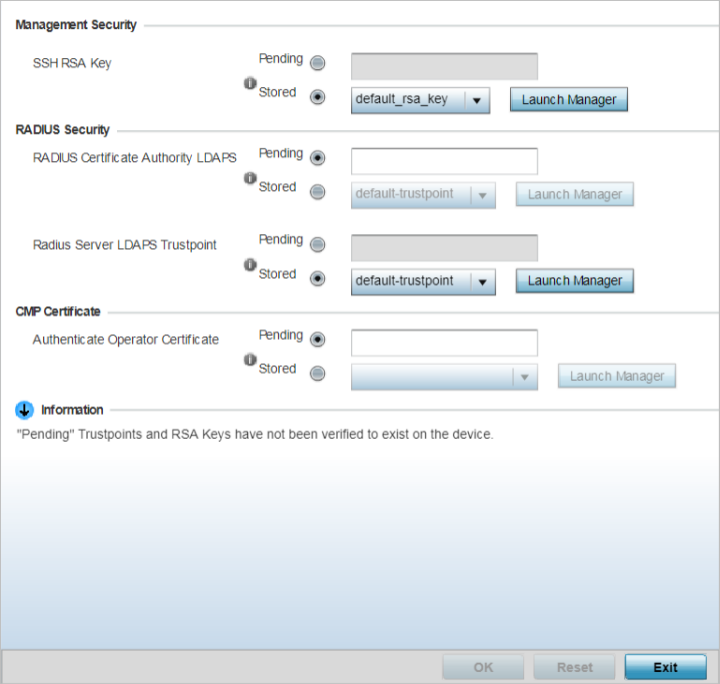

    Device Overrides - Certificates Configuration Screen
  4. In the Management Security field, set the following configurations:
    HTTPS Trustpoint
    Either use the default-trustpoint or select the Stored radio button to enable a drop-down menu where an existing certificate/trustpoint can be leveraged. To leverage an existing device certificate for use with this target device, select the Launch Manager button. For more information, see Manage Certificates.
    SSH RSA Key
    Either use the default_rsa_key or select the Stored radio button to enable a drop-down menu where an existing certificate can be leveraged. To leverage an existing key, select the Launch Manager button. For more information, see RSA Key Management.
  5. Set the RADIUS Security certificate configuration. Select the Stored radio button to enable a drop-down menu where an existing certificate/trustpoint can be leveraged. To leverage an existing device certificate for use with this target device, select the Launch Manager button.
    Pending trustpoints and RSA keys are typically not verified as existing on a device.
    RADIUS Certificate Authority
    Either use the default-trustpoint or select the Stored radio button to enable a drop-down menu where an existing certificate can be leveraged. To leverage an existing certificate, select the Launch Manager button.
    RADIUS Server Certificate
    Either use the default-trustpoint or select the Stored radio button to enable a drop-down menu where an existing certificate/trustpoint can be used. To leverage an existing trustpoint, select the Launch Manager button.
    RADIUS Certificate Authority LDAPS
    Either use the LDAP server default-trustpoint or select the Stored radio button to enable a drop-down menu where an existing certificate can be leveraged. To leverage an existing certificate, select the Launch Manager button.
    RADIUS Server LDAPS Trustpoints
    Either use the LDAP server default-trustpoint or select the Stored radio button to enable a drop-down menu where an existing certificate/trustpoint can be used. To leverage an existing trustpoint, select the Launch Manager button.
  6. in the CMP Certificate field, use the Authenticate Operator Certificate to validate the operator‘s cross-certificate with the existing vendor certificate installed on the device.
    Use the Launch Manager to view more information on the installed vendor certificates. For more information on managing vendor certificates, seeCrypto CMP Policy.
  7. Select OK to save the changes made to the certificate configurations.
    Selecting Reset reverts the screen to its last saved configuration.
