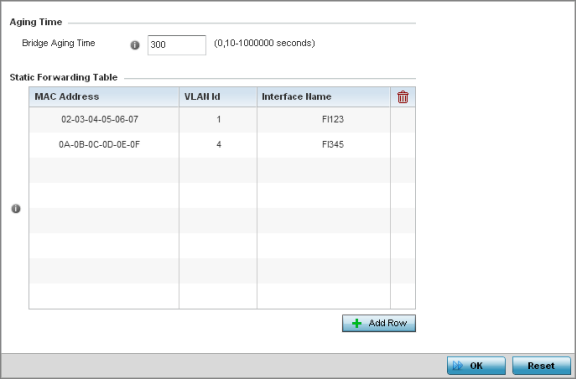

    The Forwarding Database configuration screen displays
    Profile Overrides - Forwarding Database Configuration Screen
  4. Define a Bridge Aging Time from 0, 10-1,000,000 seconds.
    The aging time defines the length of time an entry will remain in the bridge‘s forwarding table before it is deleted due to lack of activity. If an entry replenishments a destination, generating continuous traffic, this timeout value will never be invoked. However, if the destination becomes idle, the timeout value represents the length of time that must be exceeded before an entry is deleted from the forwarding table. The default setting is 300 seconds.
  5. In the Static Forwarding Table table, click +Add Row and define the following:
    MAC Address
    Set or override a destination MAC Address.
    The bridge reads the packet's destination MAC address and decides to forward the packet or drop (filter) it. If it's determined the destination MAC is on a different network, it forwards the packet to the segment. If the destination MAC is on the same network segment, the packet is dropped (filtered).
    VLAN ID
    Define the target VLAN ID if the destination MAC is on a different network segment.
    Interface Name
    Provide the name of the interface used as the target destination interface for the target MAC address.
  6. Select OK to save the changes.
    Select Reset to revert to the last saved configuration.
