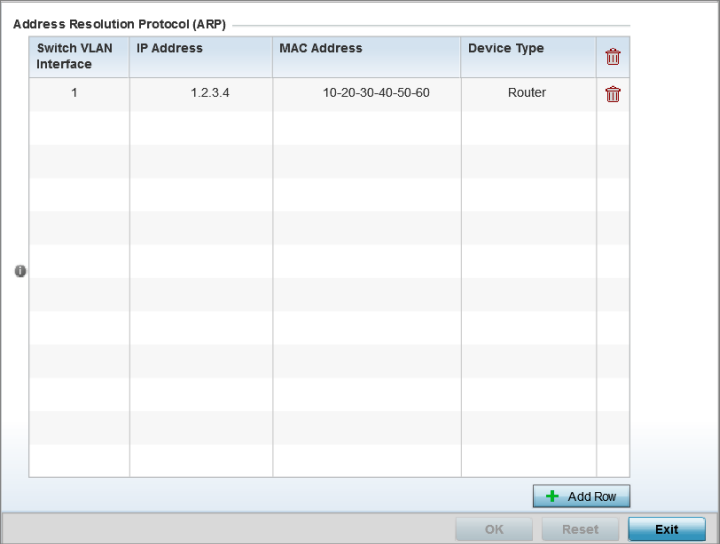

    Network - ARP screen
  4. Select + Add Row from the lower right-hand side of the screen to populate the ARP table with rows used to define ARP network address information.
  5. Set the following parameters to define the ARP configuration:
    Switch VLAN Interface Use the spinner control to select a virtual interface for an address requiring resolution with the controller, service platform or access point.
    IP Address Define the IP address used to fetch a MAC Address recognized on the wireless network.
    MAC Address Displays the target MAC address subject to resolution. This is the MAC used for mapping an IP address to a MAC address recognized on the network.
    Device Type Specify the device type the ARP entry supports. Host is the default setting.
  6. Click the OK button located at the bottom right of the screen to save the changes to the ARP configuration.
