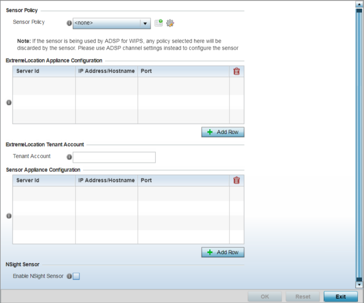

  1. Go to Configuration → Devices.
  2. Select an RF Domain from those listed on left-hand side of the UI.
    The RF Domain configuration menu displays in the left-hand UI.
  3. Select Sensor.
    RF Domain - Sensor Configuration screen
  4. Use the Sensor Policy drop-down menu to select a sensor policy for sending RSSI information to a dedicated system for device locationing calculations. Different policies can be created with either a default set of scanned channels or with custom channels, widths and weighted scan priorities. Specific channels can also be isolated and locked for specific channel scans.
    If a dedicated sensor is utilized with ADSP for rogue detection, any sensor policy selected from the Sensor Policy drop-down menu is discarded and not utilized by the sensor. To avoid this situation, use ADSP channel settings exclusively to configure the sensor and not the WiNG interface.
  5. Select the Create icon to create a new sensor policy or select the Edit icon to update the configuration of an existing policy. The Sensor Policy addition screen displays with the Scan Mode set to Default-Scan. The user configurable parameters available within the screen differ depending on the Scan Mode option selected. For more information, see Sensor Policy.
  6. In the ExtremeLocation Appliance Configuration field, select the + Add Row button to populate the ExtremeLocation server details.
    Within the ExtremeLocation Appliance architecture, sensors scan for RSSI data and send to a dedicated ExtremeLocation server resource, as opposed to an ADSP server.
    ExtremeLocation is a highly scalable indoor locationing platform that gathers location-related analytics, such as visitor trends, peak and off-peak times, dwell time, heat-maps, etc. to enable entrepreneurs deeper visibility at a venue. To enable the location tracking system, the ExtremeLocation server should be up and running and the RF Domain configuration should point to the ExtremeLocation server.
    Server Id Use the spinner control to assign a numerical ID for the ExtremeLocation server resource.
    Note: As of now only one server is supported.
    IP Address/Hostname Provide the hostname of the ExtremeLocation server resource for receiving RSSI scan data from the AP. Hostname cannot exceed 64 characters or contain an underscore.
    Note: Enter the ExtremeLocation server‘s hostname and not the IP address, as the IP address is likely to change periodically in order to balance load across multiple Location server instances.
    Port
    Use the spinner control to specify the port of the ExtremeLocation server resource receiving RSSI scan data.
    Note:
    By default, the ExtremeLocation server is reachable on port 443.
  7. Enter the ExtremeLocation Tenant‘s account number in the Tenant Account field.
    Use this field to configure your ExtremeLocation Tenant account number. Every Tenant, subscribing for the ExtremeLocation service, is communicated (via, email) an account number that uniquely identifies the Tenant. When configured in the RF Domain context, reports pushed to the ExtremeLocation server by RF Domain APs contain this account number. Including the Tenant account number reinforces the Tenant's identity.
  8. Select the + Add Row button to populate the Sensor Appliance Configuration table with up to three rows for ADSP server credentials:
    Ensure that the access points in the RF Domain have at least one radio configured in the 'radio-share' or sensor mode.
    Server Id Use the spinner control to assign a numerical ID for up to three ADSP server resources. The server with the lowest defined ID is the first reached by the controller or service platform. The default ID is 1.
    IP Address/Hostname Provide the numerical (non DNS) IP address or hostname of each server used as a ADSP sensor server by RF Domain member devices. A hostname cannot exceed 64 characters or contain an underscore.
    Port Use the spinner control to specify the port of each ADSP sensor server utilized by RF member devices. The default port is 443.
  9. Select the Enable NSight Sensor checkbox to enable the NSight module
  10. Select OK to save the changes to the Sensor configuration.
